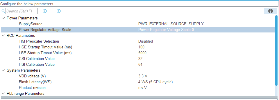

hi i have a problem where i want to get the stm to 480Mhz clock but in order to do that i have to set the Power regulator voltage scale to 0
but when i do this the micro controller bugs and i cant connect to it the programmer just say no stm32 found how can i increase the frequency ? i have my custom board i'll share anything if needed

Hello @bakhti,
The VSO0 is available only when the LDO regulator is ON.
So, to get 480 MHz, please go to the RCC parameters and modify the SupplySource "PWR_LDO_SUPPLY".
For more details please refer to the DS12556.
