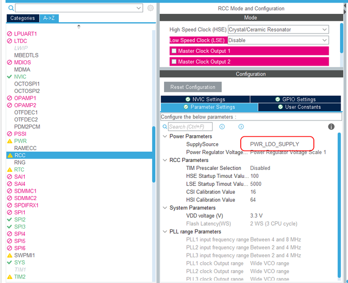

This are two things:
1) You have to correct the connection of VDDSMPS and VFBSMPS.
2) You have to tell the MCU that You want to use the LDO supply by setting PowerSource to PWR_LDO_SUPPLY under RCC ( I know, not very intuitive).

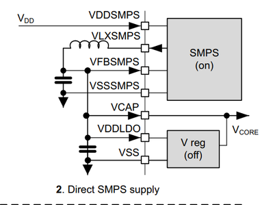

Not sure what is the power configuration of the Riverdi board? SMPS?
If so, this is the hardware required for the direct SMPS (RM0399 rev4/Figure 22):
In that case, VDDLDO is connected to VFBSMPS and not to VDD.
So please check all that hardware section.
Hope that helps.

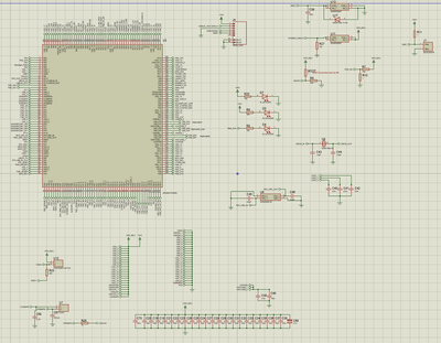

This is my full schametic of the MCU

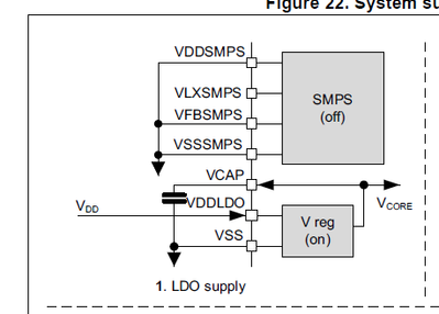

You need to follow the exact hardware schematic I provided for SMPS, otherwise there will be issues in the power.
As  mƎALLEm  has explaind Yo have to follow the  indication in the reference Manual.
If You want to use the "simple" LDO supply mode, You have to connect VDDSMPS and VFBSMPS to GND.
Any thing else can damage the MCU.

This solution is working. I believe the issue was caused by an incorrect configuration in CubeMX, which triggered the MCU to enter protection mode.
Thank you very much for your assistance.
