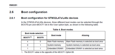

Using STM32 cube programmer I have flashed boot option using option bits and later I have flashed application and It's working fine without grounding boot0 Pin. Is there is any other way to make application start from system memory by configuring option bit in code?
2 REPLIES 2
MikaelM
hello @Sanjay8344 ,
If I well understand your question, you want to boot from system memory. to do this you have to follow the configuration as below :

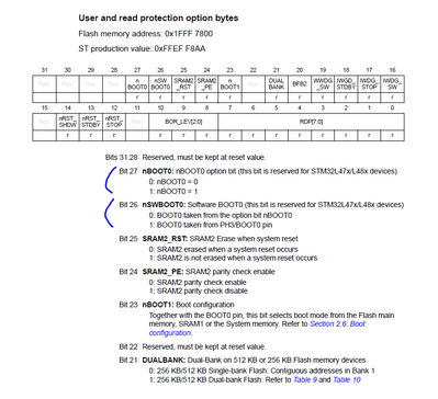

You have the possibility to use nBoot0 bit instead of Boot0 pin in the option byte area :

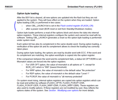

The first time you have to use OBL_Launch to force the option byte reloading :
An important point to note is this :
So I recommend you to read the reference manual of your device. Here below STM32l4x :
https://www.st.com/resource/en/reference_manual/rm0351-stm32l47xxx-stm32l48xxx-stm32l49xxx-and-stm32l4axxx-advanced-armbased-32bit-mcus-stmicroelectronics.pdf
