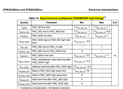

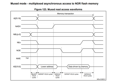

Both in the manual and in CubeMX, it is shown that my microcontroller, has the ability to configure the FMC, for an asynchronous muxed PSRAM interface.
However, in the manual I can only find the timing description for the asynchronous NOR Flash and for synchronous NOR/PSRAM.
Am I missing something here, or is it missing in the manual itself?

Hello @Giorgi_Kvernadze and welcome to the Community,
The Asynchronous multiplexed PSRAM/NOR timings tables are described in the STM32H5 datasheets.
You can check the timings Table of Asynchronous multiplexed PSRAM/NOR, in the STM32H562xx and STM32H563x datasheet
Thanks
Imen
