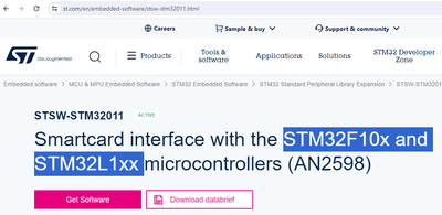

@pkolarov wrote:
Our design is using STM32F042G6 MCU to implement STSW-STM32011
So this: https://www.st.com/en/embedded-software/stsw-stm32011.html
It says it's for STM32F10x and STM32L1xx:
 so you're going to have to do some porting for your F0.
Here's a Migration Guide from STM32F1 series to STM32F0 series:
AN4088, Migrating between STM32F1 and STM32F0 series  microcontrollers:

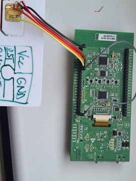

Thanks Andrew! I made a small mistake, we have actually used FW example from note AN4800. Which mentions F0 directly though for some reason L0 is mentioned as the only one supporting T=1 protocol.
So we are trying now a reference dev kit (with L0) to get working sample.  We have directly connected IO to smartcard pins without translator chip so I hope that is not some major issue for testing. For now we do get ATR but after waiting for response to command in HAL_SMARTCARD_Receive we just time out. So the card does not seem to answer further. Is there some good reference card or initial command we could use to test the example? card.jpg

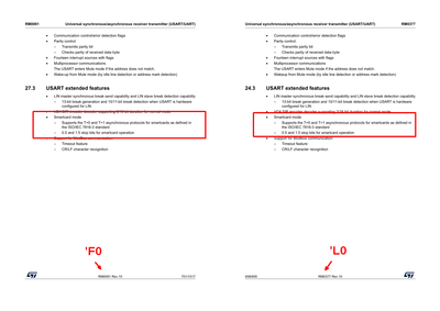

waclawek.jan
I don't have experience with the smartcard protocol on STM32, but to clarify things, are you trying to use 'F0 or 'L0?
The general description for both in RM appears to be identical, though:

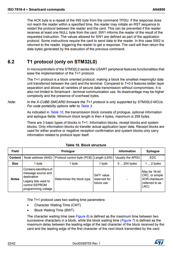

We have this AN4800
So what voltage is the card?
Not sure that it's a great idea to solder directly to the card like that - looks like high risk of damaging the card!
It also means that you can't pop the card into a "standard" reader to confirm that it is still working.
Do you have a logic analyser to see what's going on ?

AN4800 is not a generic smartcard appnote, but a specific manual to the X-CUBE-SMCARD firmware.
So, "L0" there just means, that from the selection of microcontrollers this firmware is aimed at (An application example based on STM3210B-EVAL, STM3210E-EVAL, STM3210C-EVAL, STM32L152C-Discovery and STM32L0538-Discovery evaluation boards), only 'L0 supports T1.
But that also means, that unless you want to read the manual and develop software yourself, and instead just rely on what's already ready, namely X-CUBE-SMCARD, then you have to stick to these boards.
If I'm not mistaken, it's STM32L0538-Discovery what you have on your foto above. So, do you want to use 'F0 or 'L0?
