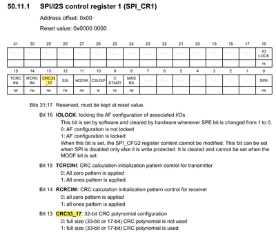

Hello, I am having an issue implementing a 32 bit CRC 0x04CDB117
I am quite confused by the documentation on how to set the a 32 bit CRC
I don't understand section 53.5.3 on the most significant bit in in CRCPOLY must be larger than the data size.
I don't understand what register CRC33-17 is referring to.
Any help or clarification would be appreciated.
Thanks
If you have a 32-bit CRC, set CRCPOLY register to 0x04CDB117 and set CRC33_17 bit in the CR1 register.
(Please include the full chip part number in the future. There are many different "STM32H7" chips.)
kip18
Thanks, this clears up my confusions. My CRC errors must be something else.

The patterns typically take the for x^32 + .. + 1, which is arguably 33-bit, in other implementations this is implied, or hidden in the hardware.
The CRC33_17 seems to relate to how it's managing the HW, and potentially 16-bit writes to the data register, and interstaging values between bytes/words.

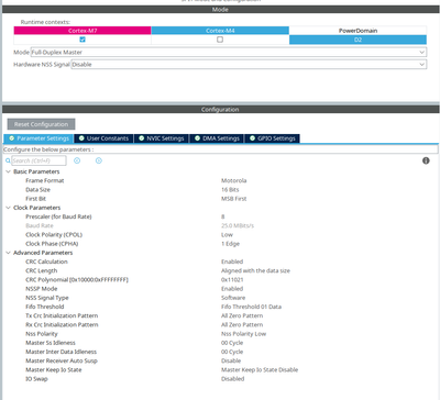

I have a working implementation with 16 bit frame length and I am trying to go to 32 bit length.
I thought it would be as simple as increasing the DMA from halfword -> word and changing the CRC to be 32 bit but I am running into CRC errors still so I assume my 16 bit implementation is more fragile than I expected.
Just communicating from one STM32H755 -> STM32H742
Transaction is just a blob of 128bytes full duplex
These are my working 16 bit settings

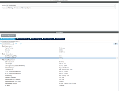

This is my 32 bit implementation which I think is correct based on the initial reply and my issue lies in my implementation and perhaps transmission lengths, still investigating. Thanks
Could be an endian-ness issue and/or interpretation issue.
Perhaps try it on 4 bytes of data which can easily be verified through one of the online CRC calculators.
Show what data you're calculating it on, what you get, and what you expect.
