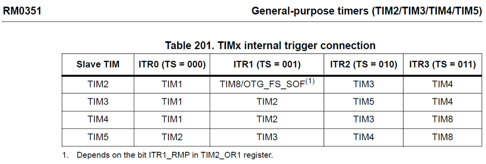

Reference Table 201 in RM0351

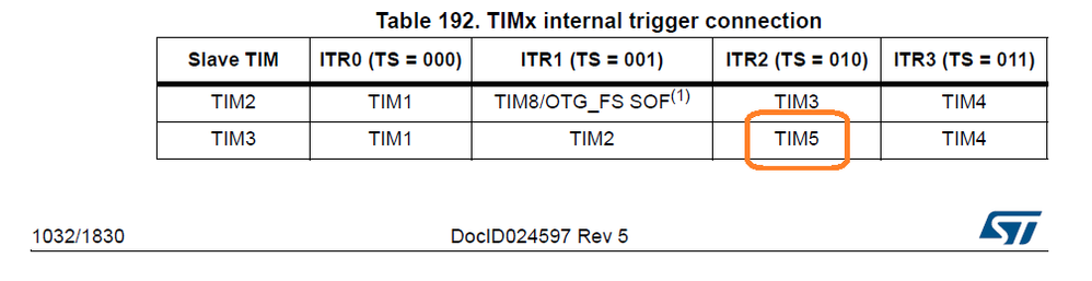

Older manual, but consistent, and not working as described
It's TIM15 not TIM5. Try.
@Imen DAHMEN​  can you please put it up to the list of things to fix in the documentation. Thanks.

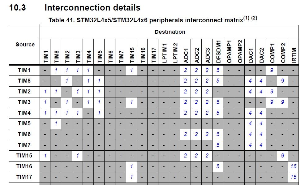

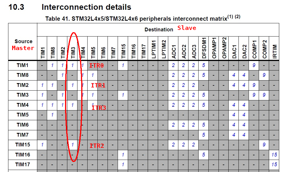

If you wonder how did I find out: remember how I always brag about the Interconnections chapter? Turns out in this case it was the one which contained the correct information...
Jan
Fair enough, but how does it associate with TIM3 (i see the TIM5 and TIM15 columns marked), got 5 boxes, and 4 ITR, or is that broken too?
I'd guess there is a mux option for TIM5 vs TIM15, but the chapter that should explain that seems a bit vacant of such detail. Just points at other tables, which in this case has an useable option documented, doesn't say TIM5 or TIM15
You have to look at the column, as it's TIM3's perspective as Slave, selected in TIM3_SMCR.TS
Ok, I was playing across not down. Wouldn't this table be more useful with boxes saying ITRx​?
Like playing battleships via sudoku.
In the timer section of the Reference Manual this is the information presented.0690X000006CGutQAG.png
I have been looking briefly through some of the Reference Manuals for STM32F family members and there is no Interconnection details section and I have always relied on the corresponding table to that inserted above. The other families present the TIM3-TIM5 connection and so the question is why make this change for the STM32L4xx series? And why not correct the information presented in the above table, this is after all revision 6 of RM0351. The same error is present in RM0392. It might be useful to have a bit in TIM3 OR1 or OR2 that enabled TIM3-TIM5 connection, just a thought!
