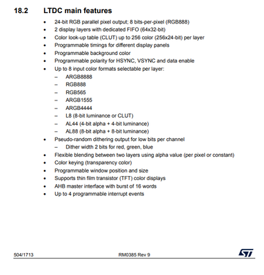

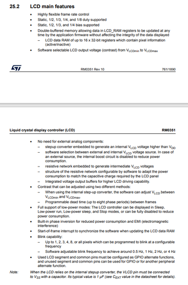

Hello @Snowcone_engineer ;
The LCD STM32L4 doesn't support two layers, unlike the STM32F7 support two layers.
You can find in the below the STM32L4 LCD  and the STM32F7 LTDC main features:
If you want to use two layers, I recommend you to use STM32F7x6/7/8/9 or STM32F4x9.... Please look at Introduction to LCD-TFT display controller (LTDC) on STM32 MCUs - Application note application note.
Thank you.
Kaouthar
