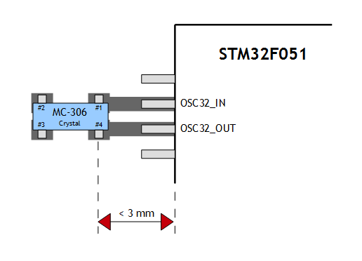

  1. Insted of a cylindrical DIP package of 32.768 kHz crystal, I used
    https://www.digikey.com/product-detail/en/EPSON/MC-306-32.768K-E3-ROHS/SER2417CT-ND/1532560
     along with two 10pF capacitors in 1206 SMD package as load capacitors CL1 and CL2
  2. Made sure that Crystal is mounted very very close (less than 3mm) to the microcontroller as shown below

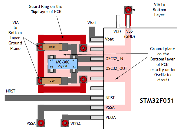

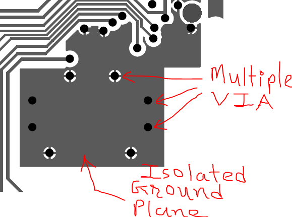

  3. Ocillator circuit has to be surrounded by a Guard Ring on the top layer of PCB, and by an isolated Ground Plane on the bottom layer of PCB as shown in below figure. The Guard Ring should be connected to underlying Ground Plane by multiple VIAs from top layer to the bottom layer.
  4. The Guard Ring and Ground Plane are to be connected only to the microcontroller ground and not to the rest of the circuit ground.
  5. Keep rest of the high frequency GPIO tracks away (more than 10mm) from the Oscillator circuit
  6. Keep the OSC32_IN and OSC32_OUT track of the same length and balanced
  7. Do not insert any test points on the tracks of oscillator circuit

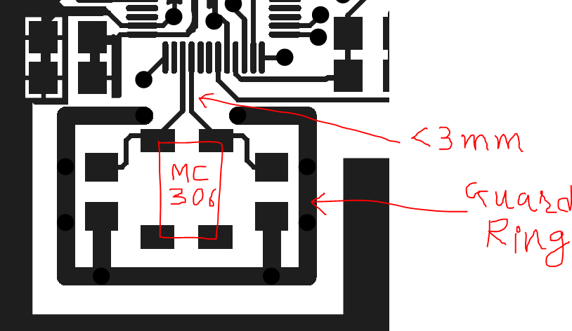

Have a Look at my final PCB layout of Oscillator Circuit
TOP SIDE LAYOUT
BOTTOM SIDE LAYOUT
After applying above mentioned changes to a newly designed PCB, the LSE crystal started oscillating without any difficulties at all.
So my suggestion to you is to redesign the PCB keeping above points in mind.
