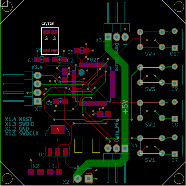

Hello everyone,
I work on a clock project and have a problem with the LSE crystal. I first
made my program on a STM32F0Discovery and it worked properly. Then I made a PCB with a STM32F030R8T6 and tried to program it but the LSE didn't start
oscillating. I looked on the forum to see if anyone had the same issues than me and I found some people that said that it's the capacitors that cause the problem. They say that you need a crystal whit two 6pF capacitors and not a crystal with two 12pF like I had. So I tried that and it didn�t work either. Can someone help me further?
The crystal I'm using can be found
http://eu.mouser.com/ProductDetail/Epson-Timing/MC-306-327680K-A0ROHS/?qs=sGAEpiMZZMsBj6bBr9Q9acukpafrIaZ1R56uLk59WWc%3d
The 12pF capacitor can be found
https://www.distrelec.ch/en/capacitor-12-pf-0805-rnd-components-rnd-1500805n120j500/p/30065870?q=258799&page=1&origPos=1&origPageSize=50&simi=98.0
The 6pF capacitor can be found
http://eu.mouser.com/ProductDetail/AVX/08055A6R0CAT2A/?qs=sGAEpiMZZMs0AnBnWHyRQEncggutzp42xImDo6lXcbY%3d

Post you PCB layout at aronud the crystal (or a photo).

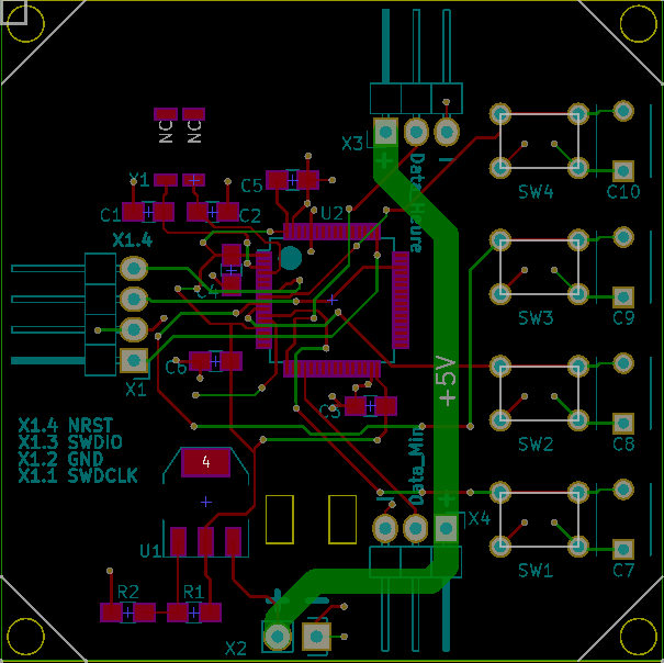

Posted on February 23, 2017 at 13:41
Here is the PCB layout as asked. If you need more just ask.
Blanc Quentin

Posted on February 23, 2017 at 14:53
I don't like the 2 vias on OSC32_IN track and OSC32_OUT track seems too long to me.
You should start laying out your oscillator first to make sure the tracks are as short as possible.
But this is not bad enough to justify why your oscillator is not starting.
The EPSON MC-306 + 6pF capacitors is in the recommended listof
/external-link.jspa?url=http%3A%2F%2Fwww.st.com%2Fcontent%2Fccc%2Fresource%2Ftechnical%2Fdocument%2Fapplication_note%2Fc6%2Feb%2F5e%2F11%2Fe3%2F69%2F43%2Feb%2FCD002216pdf%2Ffiles%2FCD002216pdf%2Fjcr%3Acontent%2Ftranslations%2Fen.CD002216pdf
so it should be compatible
Are you sure you did solder the crystal is the right direction?
