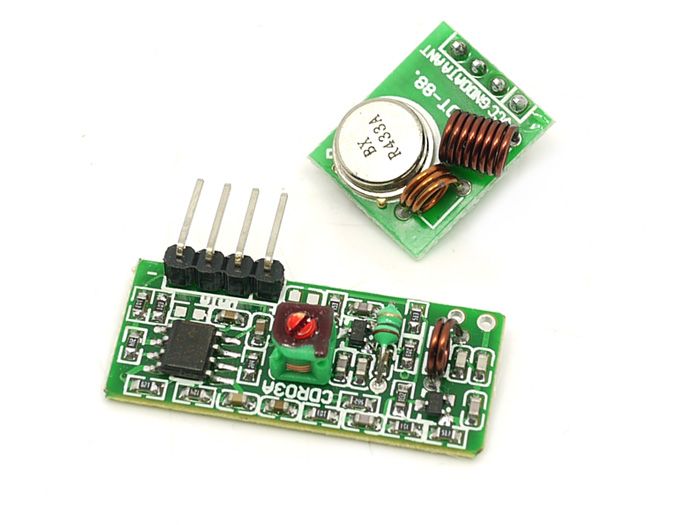

I have on radio transmitter and one radio receiver like on the picture. What I am trying to do.
I send data through USART2 PA2 (pin2) on data transmitter.
I connected usb-uart to PA2 (pin2), and looked in terminal what data is there and I saw something like this (AA 44 11 55 AA 44 22 66 AA 44 11 55 AA 44 22 66 ...).
It's okay i transmit what i want.
Then i connected usb-uart to PA10 (pin10), and looked in terminal, there was a lot of data but mostly of them was (AA 44 11 55 AA 44 22 66 AA 44 11 55 AA 44 22 66 ...).
It's okay i receive from receiver module data that was transmitted.
Then iconnected usb-uart to PA9 (pin9), and looked in terminal, there was only (AA 22 22 22 22 22 22 22 22 22 22 22 22 22 22 22 22 ...).
The main question what I am doing wrong, why USART1 TX deformates data? How to fix this?

Do you have data sheets for the receiver and transmitter pictured? Does the documentation indicate that data can be sent in this fashion, or needs to be modulated?
Use the TXE bit, not TC to determine if the USART is ready to accept new data.

And not to forget, the voltage levels need to match as well.

These modules look familiar. I had similar toys once. If you want quality products which work, buy something else.

Or at least a name and some specs., from a shop you bought it from ?
