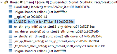

I have a project using STM32H743 and Azure RTOS, ThreadX, NetX, and FileX.
In the NetX portion during initialization of the netx thread, the code performs initiation of the LAN8742 device.
Here is the call stack tree in the debugger:

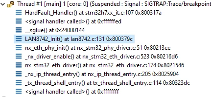

The hard fault occurs on line 131 in the lan8742.c code which is :
if(pObj->IO.WriteReg(pObj->DevAddr, LAN8742_BCR, LAN8742_BCR_SOFT_RESET) >= 0)

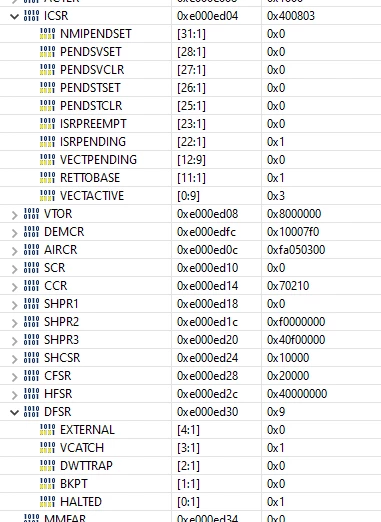

The Status registers show:
The fault is 100% repeatable.
The fault appeared after adding some code to a completely unrelated section
and the fault happens prior to any of the added code being executed. As far as I can tell
The only difference is that the added code has pushed the LAN8742.c code a
little farther down in the flash. I also noticed that some of the printf()'s for debug also
cause issues like mem faults and have to be commented out. I am not finished experimentation
with what causes the hard fault in the Lan8742 code but any comments at this pint are welcome.
Best answer by GreenGuy
This is true, but in this case not much help or at least not much different than inspecting the stack and the fault registers.  But as it turns out the error always occurs on the same statement which was a strtok call.  Further research shows the strtok call to not be thread safe.  strtok_r() is and it works.  The faults are not occurring anymore.

Look at the hard fault registers in order to determine the cause of the hard fault.
Your line of code uses a lot of data within structures. Verify the data within those structures is valid at the time of the call.

The screen shots presented in the original post are the hard fault registers?
September 28, 2023
Yeah, I don't know how I missed them. Sorry about that.

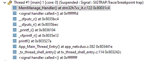

I kept adding printf statements until the error occurred again.  This time it ends up in the mem_manage handler.  The fault repeats on every run.  Commenting out the Cache Enables for I and D, one at a time, and then both, does not change the location of the error or error type.  The call stack is always:
Lacking patience for this I guess I am going to make my own terminal debug functions and put them in a thread.  Hopefully it will be a little behaved.

I made my own debug print routing in a task using HAL_UART_Transmit_DMA.  The faults keep happening.  If the DMA is busy I sleep the thread.  The faults still occur; sometimes hard , sometimes memory.  I turned my attention to how long the debug had to sleep and was quite astonished.  So I though there maybe some contention between priorities and operation with the threads.  Most of the priorities are 10.  I dropped the priority of the debug thread to 15 and raised the priority of the network threads to 9.
No more faults.
So far.
