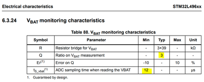

I want to monitor battery voltage (Vbat). I use the adc function to monitor voltage on the Vbat pin, and it can't read the voltage. When I use the same function on other pins, it can read correctly. For Vbat monitoring, what are the specific configurations for it?

Specific things are that your sampling time must be at least 12 us, and there is a 1:3 voltage divider on the circuit. These are covered in the datasheet.
For the sampling time topic, I configure it like this:
ts=640.5
ADC clock = 32.5 MHz
tconv = (640.5+12.5)/32.5 = 20.09 us
It is enough for the minimum requirement. Or is my calculation wrong?
Yes, that's sufficient.
