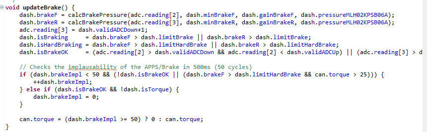

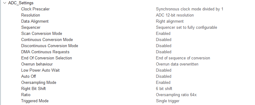

The more detailed problem is as follows : I need to reed two pressure sensor. For one the readings are fine, for the other one, every 6.5 secs the pattern shown in the picture of the original post appears, because of that some calculations done with that data acts really weird due the sudden change. Hear I attach my configuration:

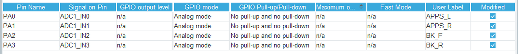

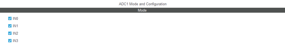

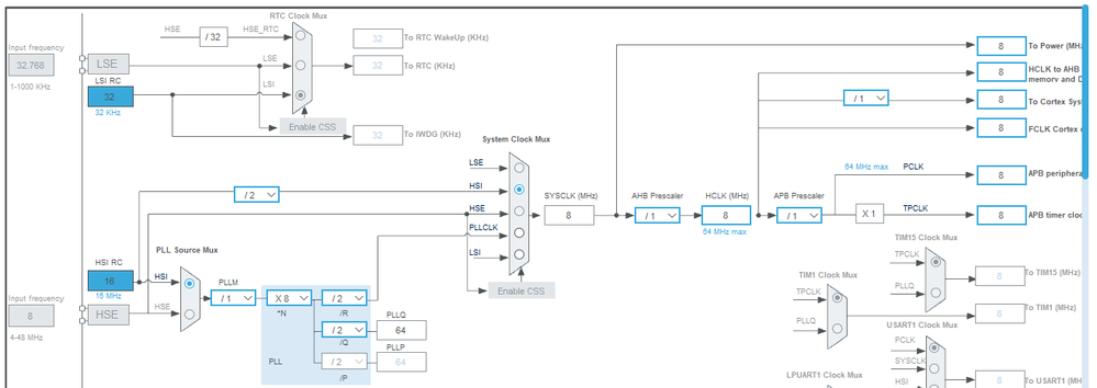

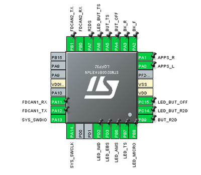

This is how I set up my periferics, where the following are used for ADC conversion
The problem ocurrs with BK_R, while BK_F works fine.

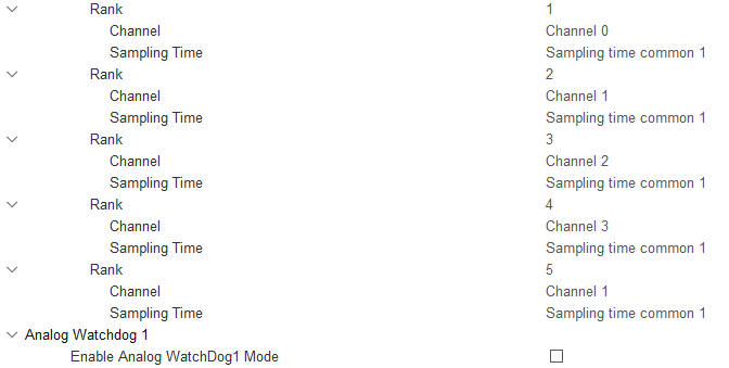

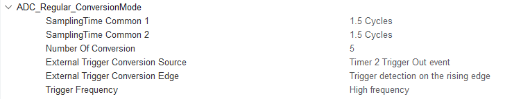

ADC configuration is:
To read the data it is used this:

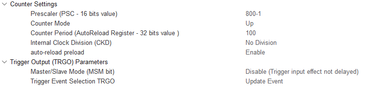

I also got a tim2 setup, I strongly believe that it is really difficult for it to cause some interference. But due to the periodic behaviour of the issue, maybe are related.

2024-02-29 1:42 PM
Is the problem with the channel going into adc.reading[3]?
That's the one to which you are assinging a value, so what if that's the reason for your problem. Try not to process the data at all and just observe them - still zeros?
