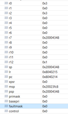

I have followed the steps you indicated. I'm working with an M0+ STM32G0B0, so I cannot access the hardfault analyzer.
r0 0x0
r1 0x0
r2 0x0
r3 0x2000437b
r4 0x0
r5 0x24
r6 0x1c
r7 0x20004360
r8 0x0
r9 0x0
r10 0x0
r11 0x0
r12 0x1
sp 0x20004360
lr 0x8040291
pc 0x80402a0
xpsr 0x0
msp 0x20023fc8
psp 0x20004360
primask 0x0
basepri 0x0
faultmask 0x0
control 0x0
centesimas=(int)parte_decimal%((int)multipliccador2/10);
0804029a: adds r3, r7, r6
0804029c: ldrb r4, [r3, #0]
0804029e: adds r3, r7, r5
080402a0: ldrh r3, [r3, #0]

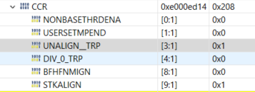

The instruction ldrh r3, [r3, #0] is using an odd address in r3 (0x2000437b). Could this be the cause of the hardfault? But what is causing this in the first place?"
Look at surrounding code. The misaligned 16 bit read is the problem. Is that from a pointer? You need to do a more guarded read where you get individual bytes to construct the word.

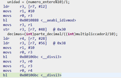

decimas=(int)parte_decimal/((int)multipliccador2/10);
centesimas=(int)parte_decimal%((int)multipliccador2/10);//->hardfault
I've been dealing with this problem for a long time. When I modify the code, the error might not reappear, or it might appear in another area of the code. It's random because, before the hardfault jumps, that piece of code may have executed 1000 times without the hardfault occurring."
Add code to make sure you aren't dividing by zero.
Determine what is generating the code that makes R3 odd, and what it's reading.
Division by 0 is not the cause. It seems it could be due to alignment? If it's due to alignment, the function where the fault occurs cannot be the cause.
You've got a couple of issues, when multipliccador2 is 1 it's going to do a modulo zero here which is a divide by zero
You can perhaps reorder this?
decimas=(parte_decimal / multipliccador2) /10;
Or handle the numero_decimales == 0 case differently?
if (((int)multipliccador2/10) == 0) puts("Hazard!");
if (numero_decimales)
Also not clear where this code came from, which WILL fault if the pointer is misaligned.
You’re right about that. I’ve already fixed it. I was saying that’s not the problem, because when the hardfault occurs, I check the variables and none of them are causing a division by zero.
fernandogamax
I’ve changed the code so that a division by 0 can never occur, although, as I mentioned earlier, this case never actually happened in my tests.
When I use this code, a hard fault occurs:
uint32_t decena_millar = (uint32_t)((numero_entero / 10000) % 10);
uint32_t unidad_millar = (uint32_t)((numero_entero / 1000) % 10);
uint32_t centena = (uint32_t)((numero_entero / 100) % 10);
uint32_t decena = (uint32_t)((numero_entero / 10) % 10);
uint32_t unidad = (uint32_t)( numero_entero % 10);
When I use this other code, no hard fault occurs:
uint32_t decena_millar = (uint32_t)((numero_entero / 10000));
decena_millar=decena_millar% 10;
uint32_t unidad_millar = (uint32_t)((numero_entero / 1000));
unidad_millar=unidad_millar%10;
uint32_t centena = (uint32_t)((numero_entero / 100));
centena=centena%10;
uint32_t decena = (uint32_t)((numero_entero / 10));
decena=decena%10;
uint32_t unidad = (uint32_t)( numero_entero );
unidad=unidad%10;
It doesn’t make sense—I think the problem hasn’t been solved; it’s just been moved somewhere else.
Another thing I’m thinking about: a few months ago I migrated the project from STM32CubeIDE 1.12.1 to STM32CubeIDE 1.18.0. We’re seeing that before this migration we never encountered this issue. Could that be the problem?
