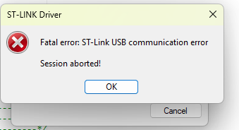

But when I tried following in section 4, to use IAR workbench I got following error

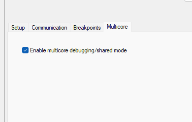

What I have found is ticking multicore support in IAR gives the erro
I was able to debug individual cores if I don't enable multicore.
Any guidance is deeply appreciated.

‎2024-07-15 2:12 AM
Refer to the AN5286 "STM32H7x5/x7 dual-core microcontroller debugging", section 4 Using IAR Embedded Workbench™ for Arm®
‎2024-07-15 2:26 AM
Make sure IAR version you're using has most current drivers and DLLs for ST-LINK installed.
Check for IAR IDE patches in CubeH7 Software directory in repo or ZIP file.
‎2024-07-15 2:48 AM
Many thanks for the quick response.
@mÆŽALLEmAs mentioned in my original post, I have already followed AN5286.
@Tesla DeLoreanI copied all the patch files over to IAR "C:\Program Files\IAR Systems\Embedded Workbench 9.2\arm" and restarted IAR. But still getting the same error message.
‎2024-07-15 2:50 AM
The link you shared pointed to: https://www.st.com/resource/en/application_note/dm00629855-getting-started-with-projects-based-on-dualcore-stm32h7-microcontrollers-in-stm32cubeide-stmicroelectronics.pdf
Which is not the correct link :)
‎2024-07-15 2:52 AM
Appolgies for the wrong link. I have followed the AN5286 and landed to this issue.
‎2024-11-11 1:30 AM
I'm experiencing the same issue. I'm using EWARM 9.2 to connect to the H755ZI board with the STLINK-V3SET, enabling Multicore/share mode to attempt multicore debugging, but I encounter the same problem. Have you managed to resolve this issue? If so, could you let me know how you did it?
