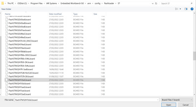

Hello @Harsh_Gajjalwar and welcome to the Community;
Do you want to generate .stldr file using IAR?
If yes, I advise you to start with an available STM32H7x_boards project example and get inspired from this FAQ to create your own external loader to manage external memories using IAR toolchain.
You can find .board files under this path "..\Program Files\IAR Systems\Embedded Workbench 9.0\arm\config\flashloader\ST "
Is my reply answer your request?
Thank you.
Kaouthar
