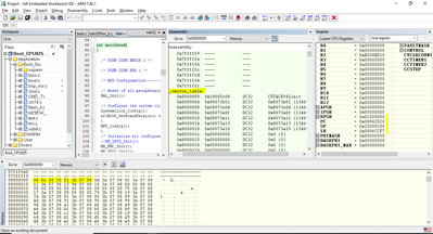

I haven't attached any code examples because the same .s19 file when loaded using ST Flash Loader or J-Flash worked, Only when i use a UART communication with our in-house tool to download the code it is unable to jump to the vector table location, so I thought it has nothing to do with the code but the jump from internal bootloader to user code.
I have attached 2 images below:
1] Working condition where i have loaded the user code using ST Flash Loader tool and UART communication
And after loading i do a "Debug without downloading" on my IAR tool, which helps debug the code which is already present in the flash

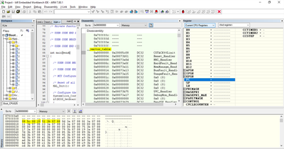

2] Non-working condition where i have loaded the user code using an in-house tool using UART communication
I do the same steps here after downloading the .s19 file and as we can see here the address location 0x08000000 has SP value (same as first image, where it is working fine), and the reset handler after 4 bytes. But the control is not jumping to main. Also if you see on the right side none of the Registers are getting initialized to any value.
Additional to the ST Flash Loader commands I am sending a "Go command" and the address location as 0x08000000 from the in-house tool after download is complete, but it is not able to jump to the specified location.
