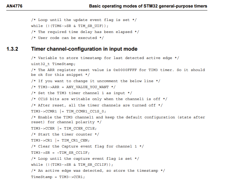

My goal is to use the register based approach to mesure the period of an incoming square wave.
and basically I followed this paragraph in AN4776

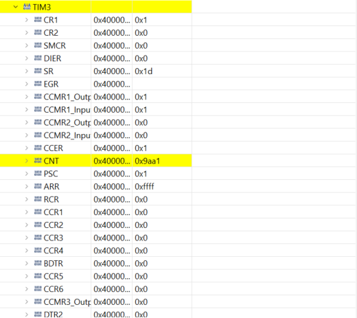

HI @Community member
These are the registers settings while I am doing input capture on PA6/Tim3_Ch1 with the code I shared in my last post
Ok I will try also to generate a pwm with this timer. I will let you know as soon as I do it
Thanks a lot
2022-05-18 8:52 AM
GPIOA->MODER6 = 0xabfff7bf => for PA6 the MODER field is 0b11 - note that GPIOx_MODER in 'G4 is not zero after reset.
