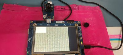

hello @athern27 .
You mentioned  that you successfully configured the IMX335 sensor to output from 2592x1944 down to 256x256 resolution using window cropping.
I'm trying to configure the sensor to output at 640x480 resolution, but it’s not working as expected. Below are the changes I’ve made, based on the datasheet (Window Cropping Mode):
1 . HNUM
{0x302e, 0x80},
{0x302f, 0x02},    // 0x0280 = 640 pixels
2 . AREA3_WIDTH_1
{0x3076, 0xc0},
{0x3077, 0x03},    // 0x03C0 = 960 (480 lines * 2)
>>> Set AREA3_WIDTH_1 to twice the number of the lines  . given in datasheet
3. Y_OUT_SIZE
{0x3056, 0xe0},
{0x3057, 0x01},  // 0x01E0 = 480 lines
4.  changes for DCMIPP Configuration.
pPipeConf.PixelPipePitch  = 1280 ;    // 640 * 2
DonwsizeConf.HSize = 640 ;     //800 ;
DonwsizeConf.VSize = 480 ;
5 . changes for LTDC Configuration :
pLayerCfg.WindowX0 = 0;
pLayerCfg.WindowX1 = 640 ;   //Width;
pLayerCfg.WindowY0 = 0;
pLayerCfg.WindowY1 = 480 ;   //Height;
Even after applying all these settings, the image appears not as expected on the display.
Could anyone please help me understand what might be missing here?
@athern27 — If possible, could you please share your working source code and sensor config ZIP file?
Any help from the community would be greatly appreciated.
Thank you!
