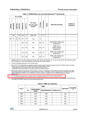

In 'F4, for FT pins with analog functionality (marked as FT_a in other STM32 families' DS), there's a clear warning, that 5-volt tolerance does not apply when given pin is set to Analog mode:

In fact, and you're right, the same conditions also apply to G0 (and also all STM32), as the FT_a IOs are referenced to the VDDA.
However, there is a general information mentioned in the AN4899 section 5.2.2 Five-volt tolerant GPIO (FT).
The maximum operating voltage on pin FT_a cannot exceed min(VDDA, VREF+) + 0.3 V.
Best regards,
Romain
