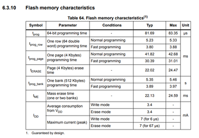

Hello @Martin42
Flash programming is only by 64-bits at a time. On other series it can be 32-bits.
For more details refer to this post.
Best Reagrds.

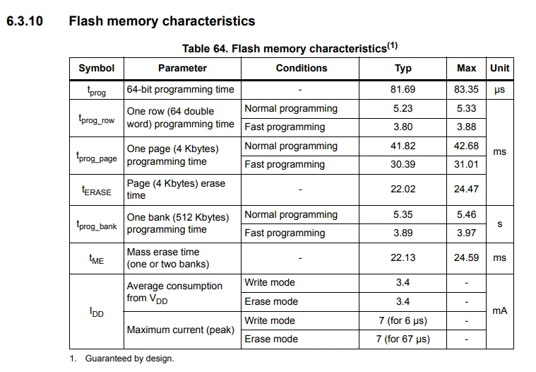

Hello @Martin42
Best Reagrds.
