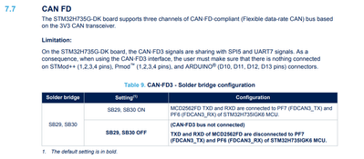

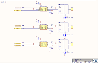

Hello, I'd like to inquire if the STM32H735G-DK supports a CAN FD transceiver, or if I should purchase an external transceiver
mƎALLEm
No need to add external tarnceivers:
From the board's schematics you have three CAN interfaces on the board each one having its own transceiver:
From the board's UM2679 :
So read carefully the "limitation" section.

mƎALLEm

Just one more thing: be careful where you connect it, these are non-isolated interfaces.
