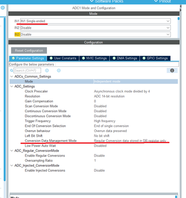

Here is my MX config:
IN1 enabled, and expecting the data to be stored in the DR register.

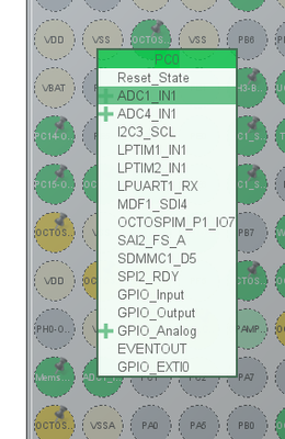

PC0 is selected as ADC1_IN1:

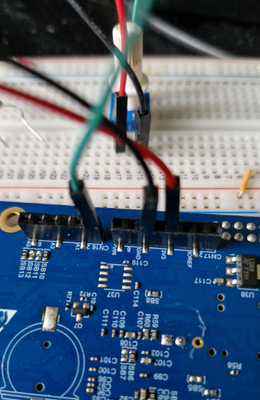

And the answer is: Yes, I have tried to direct hot wire the 3.3V pin from connector CN17.
I have also tried to use a potentiometer(This is my standard setup):
When I measure the PC0 pin (Green cable in my setup), I can see that it is between 0 and 3.3V based on the potentiometer position.

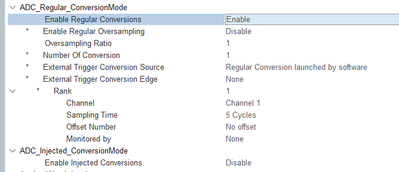

Rubber ducking success!!
After re-reading my own post here, and playing around with the CubeMX settings for the ADC, I finally got it to work.
After changing "Enable Regular Conversions" to Enable, it magically started to work.
