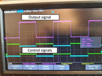

This is both PWM signals at 50% duty, and work as intended

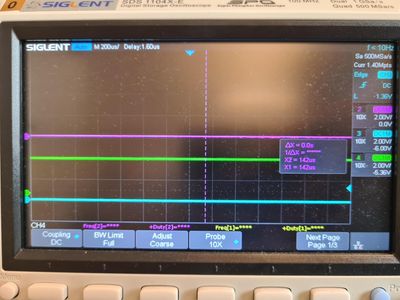

This is the Advanced timer at 0% duty, and as expected the output is now 0 with 1 signals hight and 1 low

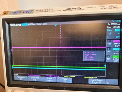

This is the General timer at duty 0%

waclawek.jan
On those pictures, green and blue are the two complementary outputs, correct? And what is the purple one?
Read out and compare/post TIM registers content for the two timers (and perhaps also the relevant GPIO registers content).

The purple one is an output controlled by the two complementary outputs depending on their duty.
