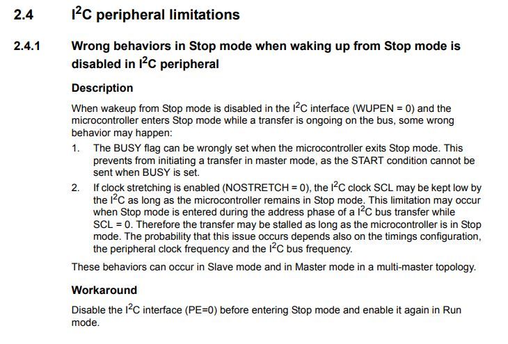

I try to implement I2C slave so it behaves like a typical EPROM and master can read/write using HAL_I2C_Mem_Read/HAL_I2C_Mem_Write functions.
After 3 days of searching and trying I found only one, partially working example: STM32F072 I2C slave Receive callback
Problems:
  1. Communication seems to work only when clock stretching is disabled (Clock No Stretch Mode = Enable/I2C_NOSTRETCH_ENABLE). Enabling clock stretching causes slave to pull SCL line down indefinitely once it receives its address.
  2. Description of I2C_XFEROPTIONS (I2C_FIRST_FRAME, I2C_NEXT_FRAME, I2C_LAST_FRAME) found in UM1940 is completely cryptic and no description in HAL source code is found.
  3. I am able to receive data but not to send. I receive odd address, call HAL_I2C_Slave_Seq_Transmit_IT(hi2c, &_dataBuffer[_offset], 1, I2C_NEXT_FRAME) and that results in HAL_I2C_ERROR_OVR error.

Hello @TJast​ ,
You can review the STM32L0 errata sheet related to your devices to check the known I2C peripheral limitations and if you have the same condition (If clock stretching is enabled).

@Imen DAHMEN​ Thank you for the hint but in my case processor does not enter Stop mode. It must be something else.
