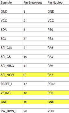

Hello everyone. I am writing to you because I am trying to capture a thermal image (frame of temperature values) using a Lepton 2.5 thermal camera with Break Out board 2.0 connected to a Nucleo U5A5ZJ-Q board. First I connected the following pins of the Break Out board 2.0 to the Nucleo board, as shown in the table below.
I have not inserted pull-up resistors or software pull-ups on SDA and SCL.
