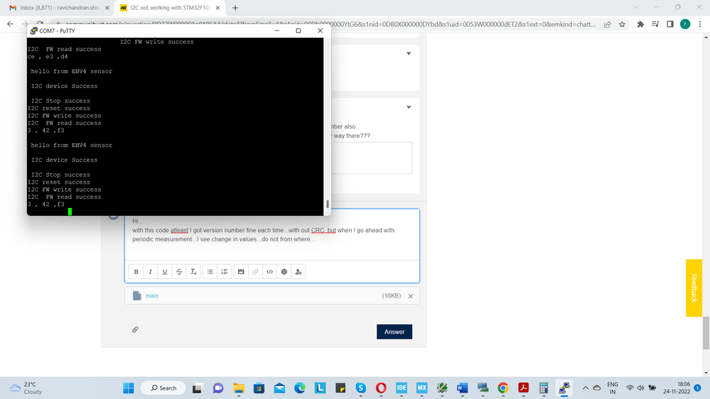

‎2022-11-24 04:36 AM
Hi ,
with this code atleast I got version number fine each time...with out CRC..but when I go ahead with periodic measurement...I see change in values...do not from where...
‎2022-11-24 04:44 AM
when I flash the previous code I shared with you ..I am able to get the version number..once I had any set interval or periodic measurement...version number values change and also ...periodic measurement fails...not able to understand where the probelm is??

‎2022-11-24 05:08 AM
I changed the code where I coulf get the version number right..but when I read the get data ready..giving me same version number values..let me know where the problem is ??
sometimes when I restart gives me ddddd values..do not know why??

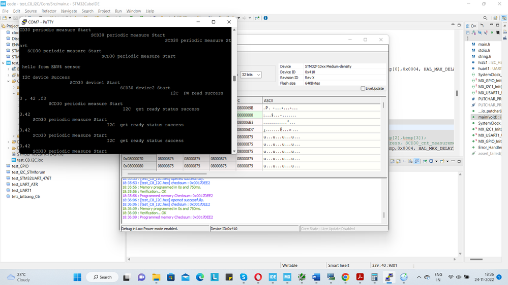

‎2022-11-24 08:50 AM
me too :)
and i am sick...and cannot concentrate.
here the crc8 you need: (if chip refuses to work without crc byte)
> put gencrc() in your test program
and do:
- start continous mode
- in while...
- wait for data ready stat
- read data
- < while

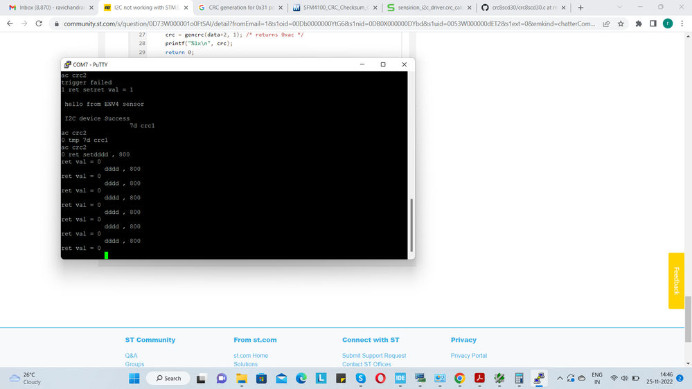

‎2022-11-25 01:16 AM
Hi ,
As suggested I generated the CRC and also the start continuous mode ..
looks like CRC is not generating as 9x92 instead getting 0x7d..any error let me know
I am getting data ready flag as 1.....
regards
Ravi
‎2022-11-25 02:40 AM
I changed the code a bit ..here I am getting 0x92...but data available function has to return with set as 0x01...let me know if you get anything out of this..
