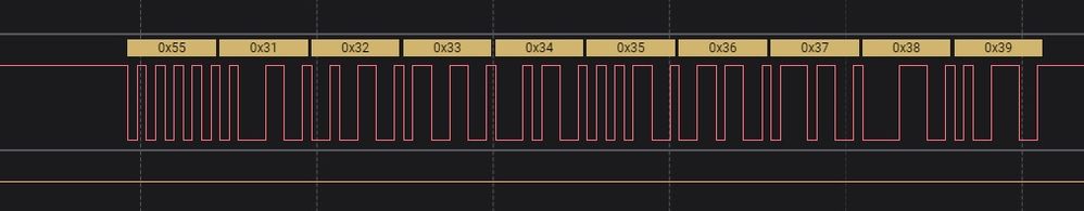

 From the terminal to the microcontroller in UART, I send the character set U123456789, and the microcontroller sends the same character set back to the terminal, and this happens at different baud rates. Everything works great!!!

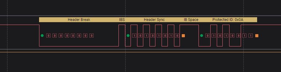

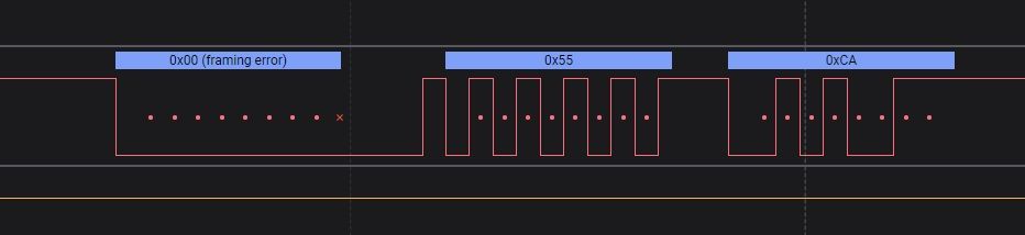

My assumption is that the microcontroller cannot automatically detect the baud rate due to the break field. If you work with a regular yuart, then the frame starts from 0x55 and this one worked. But when working with LIN, there is a break field before the synchronization field, due to which a frame error may occur. Возможно, по �?той причине автоматиче�?кое определение �?коро�?ти передачи не работает в режиме LIN UART.
This is how the frame looks from the master device to the LIN transceiver
0693W00000WJj5qQAD.jpgThis is a frame converted LIN transceiver to UART
