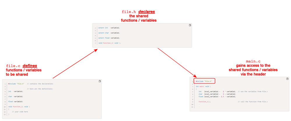

Hi all, I am fairly new in using STM32CubeIDE. I am working with three peripherals (uart1, uart2 and CAN) as also a timer interrupt in the STM32F103C8. I have written all the code in the main.c file. It is working but the coding is a bit jumbled up. For better readability, I want to put different functions of the three peripherals and the timer in different source files and call them from the main function. I am adding new c source files in the src folder but I have trouble in accessing the functions placed in these files from the main.c file. Can anybody please guide me in this matter?

As @mƎALLEm said, you use header files (.h) to provide the declarations of the things you want to share.
This is standard C stuff - nothing specific or special to CubeIDE:
https://c-faq.com/decl/decldef.html
eg, file.h provides declarations:
extern int variable1;
extern char variable1;
extern float variable1;
void function_1( void );
file.c provides definitions (or "implementations"):
int variable1;
char variable2;
float variable3;
 // your code here
Now, for example, your main.c can access things from file.c by #including file.h:
#include "file.h"
int main( void )
 int local_variable1 = 2 * variable1; // use the variables from file.c
 char local_variable2 = 3 + variable2;
 float local_variable3 = 2.3 / variable1;
 function_1(); // call the function from file.c

Here is a pictorial summary:

One thing I omitted to mention is that it's good to also #include your file.h header in your file.c source file.
So, in file.c:
#include "file.h" // contains the declarations
 // here are the definitions:
int variable1;
char variable2;
float variable3;
 // your code here
This means that the Compiler, when it compiles file.c, gets to see both the declaration in file.h and the definitions in file.c - and, thus, can warn you if there's any discrepancy.
