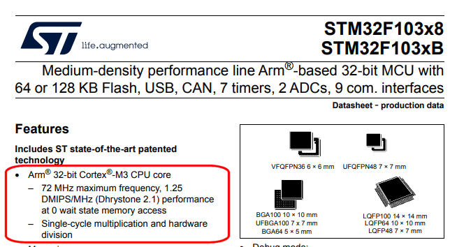

EDIT:
What speed are you running your STM32F103? A genuine ST chip would go up to 72MHz ...
I am running my blue pill at 72 MHz.
