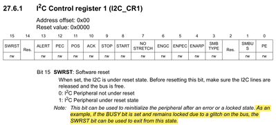

What you're doing should be working as far as I understand. However, it looks like you can also use SWRST to reset the bus when BUSY is locked, which is quite a bit easier than reinitializing pins.

If I understand correctly, the macros you mentioned earlier are setting that SWRST bit to 1 (reset) and then to 0 ('not reset'), which is resetting the entire I2C1 bus. Is that right? I have to squint a little at understanding what these macros are doing, and I'm still learning how I might have found those on my own.
But in any case, this is terrific! You've shown me how to read and understand these lower-level registers in a practical way, and now I can learn more about how to use them to fix stuff like this. Exactly the kind of thing I was hoping to learn by being stubborn about solving this. :)
I will gladly choose a different part - I have a handful of various magnetic encoders here, and all of this started from me wondering "why would I choose one over the other?"
Thank you again so much, and - if I may - happy holidays.
It'll reset the internal I2C1 peripheral state machine without actually affecting the SDA/SCL lines at all, which will clear the BUSY bit. It should do the same as the deinit/reset/init code you posted:
SET_BIT(I2C1->CR1, I2C_CR1_SWRST);
CLEAR_BIT(I2C1->CR1, I2C_CR1_SWRST);
I think the stop condition above didn't work because when the pins are reinitialized as output, they're disconnected from the I2C peripheral. That was my mistake.
