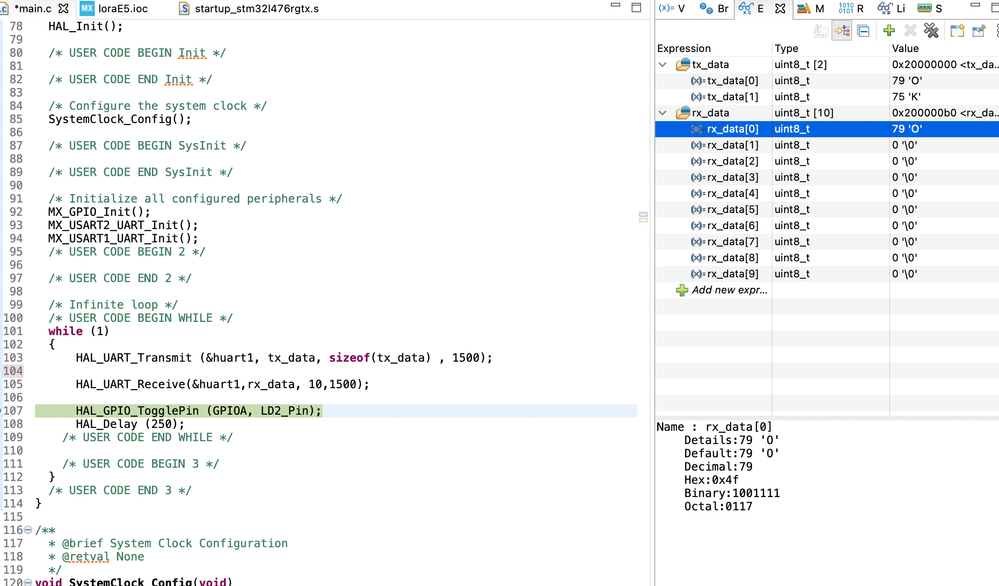

I am trying to read UART and to hold on rx_data array. when I send "AT" to rf module it returns "OK" , but on my code I cannot receive anything from UART. and help appreciated
‎2021-12-23 4:58 AM
uint8_t tx_data[2] = "AT";
uint8_t rx_data[10];
HAL_Delay(1000);
while (1)
HAL_UART_Transmit (&huart1, tx_data, sizeof(rx_data) , 250);
HAL_Delay(500);
HAL_UART_Receive(&huart1,rx_data, 20,1000);
HAL_GPIO_TogglePin (GPIOA, LED_Pin);
HAL_Delay(500);

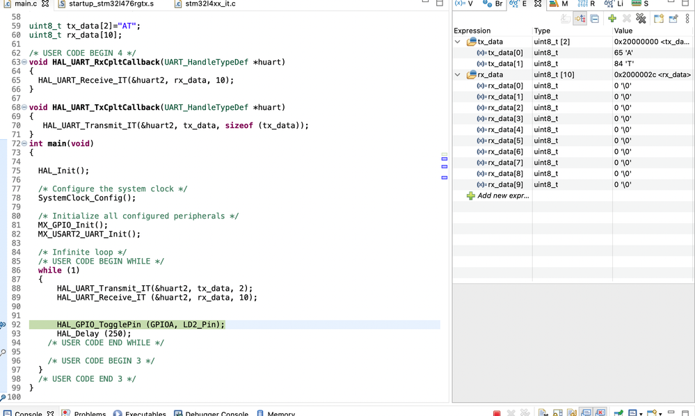

I did like this , tried with both "AT" and "AT\r\n" same
uint8_t tx_data[4]="AT\r\n";
/* USER CODE BEGIN 4 */
void HAL_UART_RxCpltCallback(UART_HandleTypeDef *huart)
HAL_UART_Receive_IT(&huart2, rx_data, 10);
void HAL_UART_TxCpltCallback(UART_HandleTypeDef *huart)
HAL_UART_Transmit_IT(&huart2, tx_data, sizeof (tx_data));
int main(void)
HAL_Init();
SystemClock_Config();
MX_GPIO_Init();
MX_USART2_UART_Init();
/* Infinite loop */
/* USER CODE BEGIN WHILE */
while (1)
HAL_UART_Transmit_IT(&huart2, tx_data, 4);
HAL_UART_Receive_IT (&huart2, rx_data, 10);
HAL_GPIO_TogglePin (GPIOA, LD2_Pin);
HAL_Delay (250);
/* USER CODE END WHILE */
/* USER CODE BEGIN 3 */
/* USER CODE END 3 */
‎2021-12-23 11:23 AM

‎2021-12-23 11:28 AM
No change to nonblocking IT code i say only enable IRQ nothing more.
Normal call isnt POLL but blocking .
IT and DMA is non blocking offload code.
Blink work?
And use
HAL_UART_Transmit (&huart2, "AT\r\n", 4 , 250);
HAL_UART_Receive(&huart2,rx_data, 10,1500);

now I tried to test other UART pins(uart1) , I shorted pins, now I receive only the first character of the data . how can I get all the transmitted data at once?
‎2021-12-23 12:28 PM
I changed the uart port it worked, thank you very much. don't know why on uncle uart2 , PA2,3 didn't work
