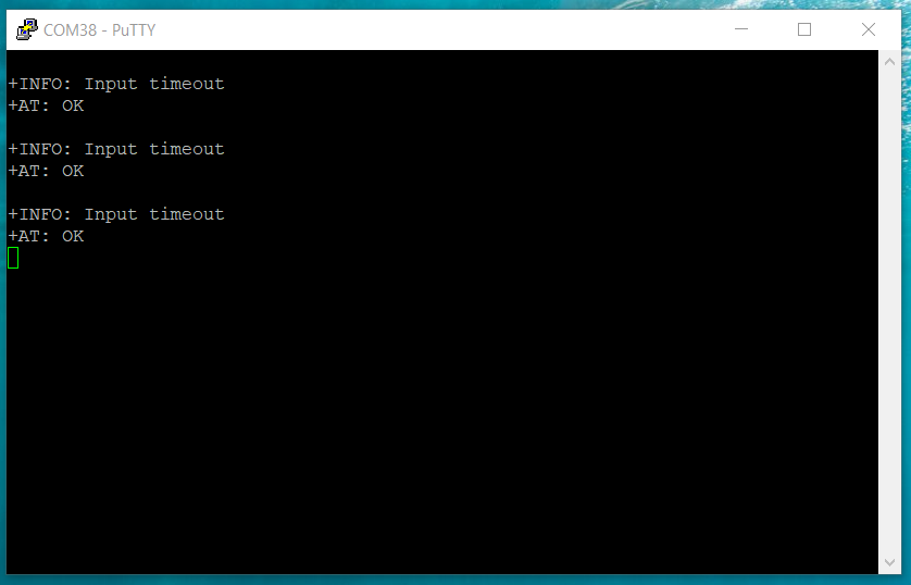

I did check, I used on other MCU with python code I am able to communicate , but when I moved to stm32 , I cannot get response from rf module. it doesn't require "\r\n" at the end of commands. when I connect rf module to Putty via FTDI , it works like fine like on screenshoot below . 0693W00000Hpfy2QAB.png
Dont seems be fine, input timeout say problem, but other.
Your putty dont have echo on then here isnt showed your send AT
with or without enter usw...

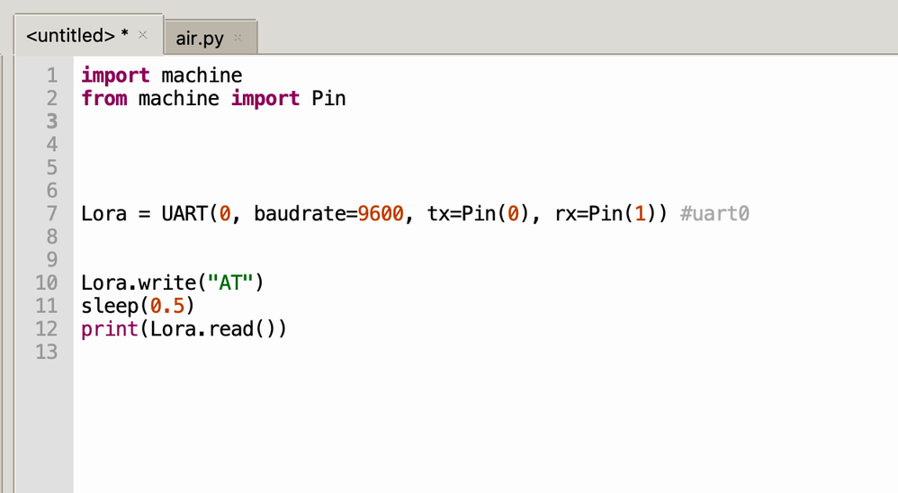

same RF module works with this simple python code,
