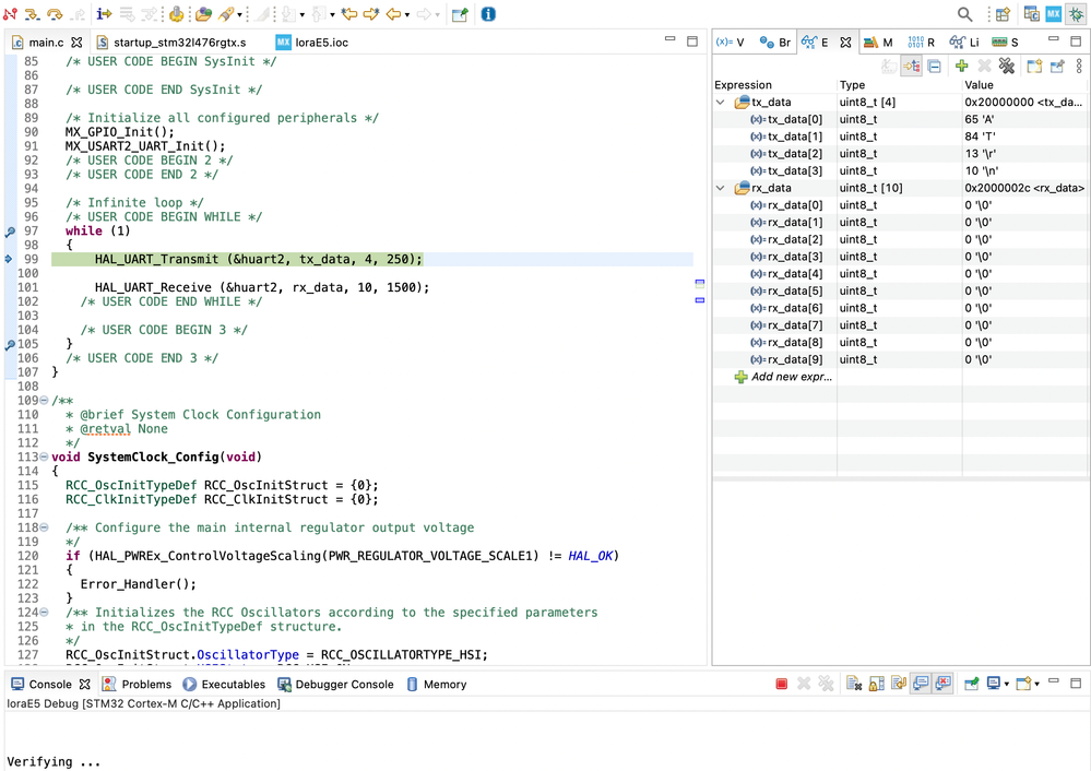

I am trying to read UART and to hold on rx_data array. when I send "AT" to rf module it returns "OK" , but on my code I cannot receive anything from UART. and help appreciated
TPiri.1
uint8_t tx_data[2] = "AT";
 uint8_t rx_data[10];
 HAL_Delay(1000);
 while (1)
 HAL_UART_Transmit (&huart1, tx_data, sizeof(rx_data) , 250);
 HAL_Delay(500);
 HAL_UART_Receive(&huart1,rx_data, 20,1000);
 HAL_GPIO_TogglePin (GPIOA, LED_Pin);
 HAL_Delay(500);

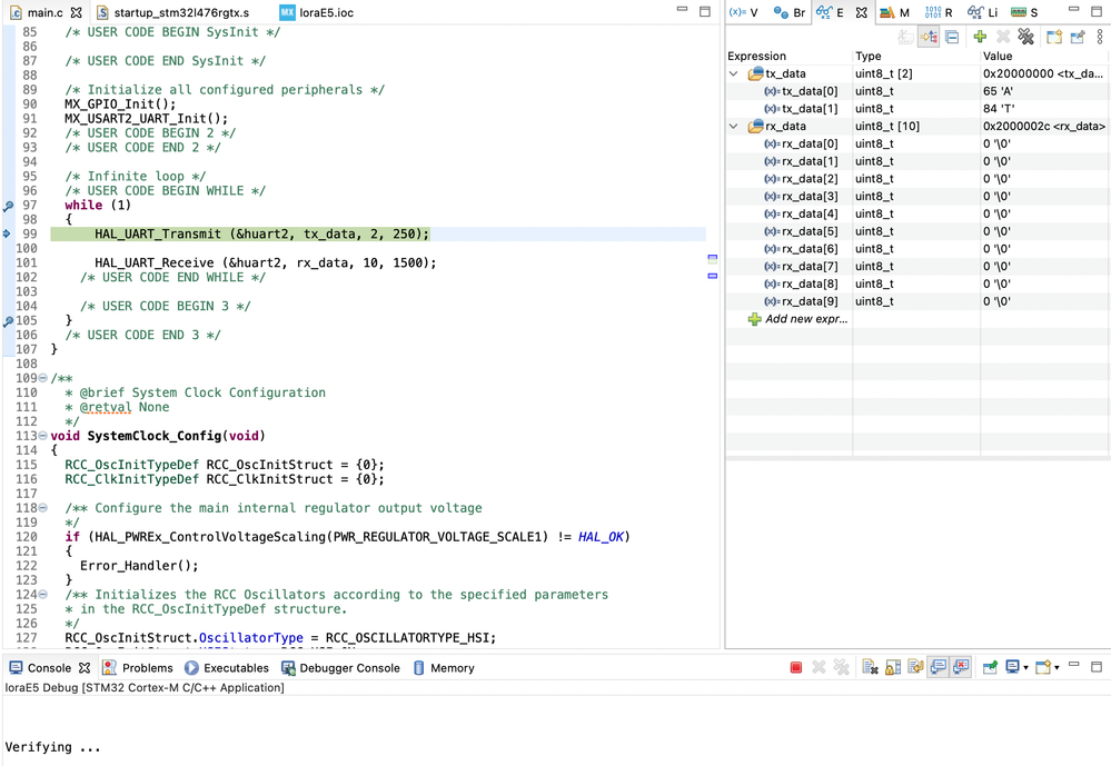

I tried "AT\r\n" as well , same result , no data from uart

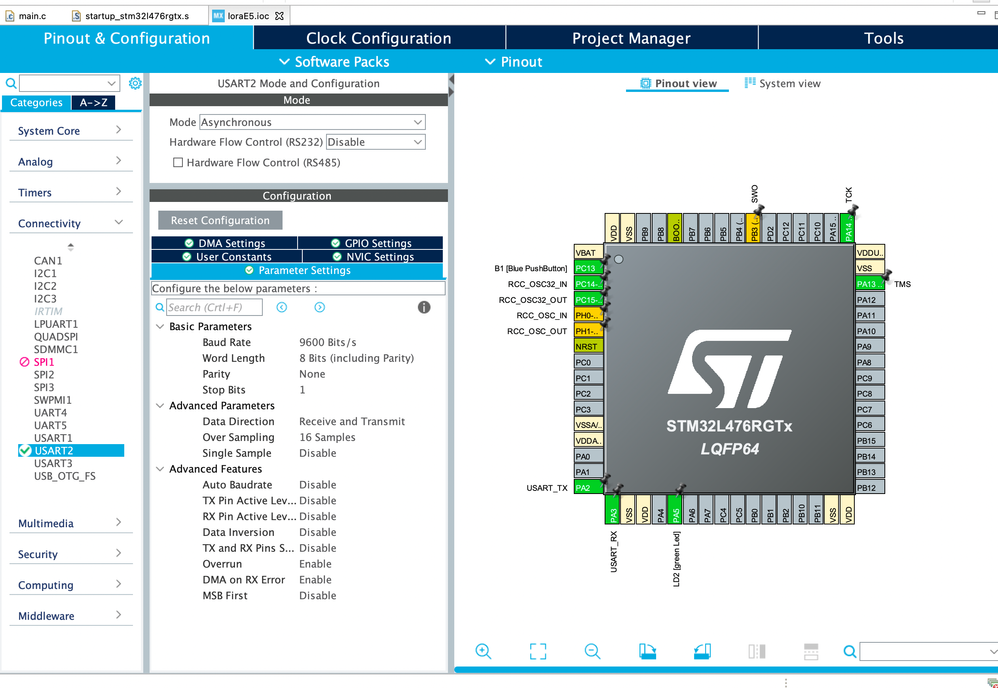

have you initialised UART properly parity num bits speed ?
I think so, only changed baud rate to 9600

on NVIC Settings have you enabled IRQ USART?
no, I haven't . I don't use interrupt, I am using POLL method
This need too be enabled

even though I use simple uart POLL method still I have to enable this?
with debugger I can see what is inside rx_data and tx_data , I tried both method with/without "\r\n". same , screenshot below0693W00000Hpgf1QAB.png0693W00000HpgfQQAR.png
