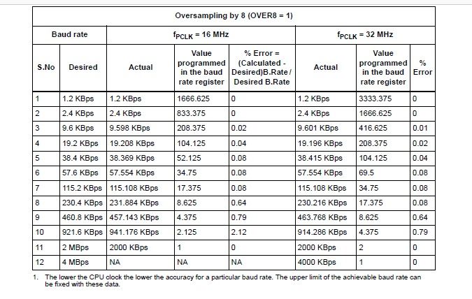

Please correct my configuration ?
void MX_USART3_UART_Init(void)
 huart3.Instance = USART3;
   huart3.Instance->BRR=34;
 huart3.Init.BaudRate = 115200;
 huart3.Init.WordLength = UART_WORDLENGTH_8B;
 huart3.Init.StopBits = UART_STOPBITS_1;
 huart3.Init.Parity = UART_PARITY_NONE;
 huart3.Init.Mode = UART_MODE_TX_RX;
 huart3.Init.HwFlowCtl = UART_HWCONTROL_NONE;
 huart3.Init.OverSampling = UART_OVERSAMPLING_8;
 if (HAL_UART_Init(&huart3) != HAL_OK)
   Error_Handler();
I read from :

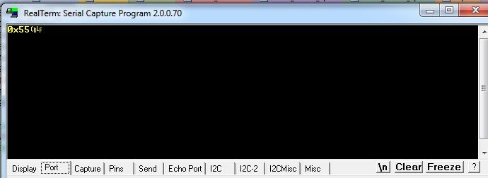

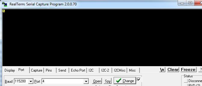

baudrate 115200 clock = 2.097Mhz
Send 0x55, code
  printf("0x55");
   printf("\r\n");
output :
clock = 32Mhz,
baudrate = 115200
output :
any clues ? thanks

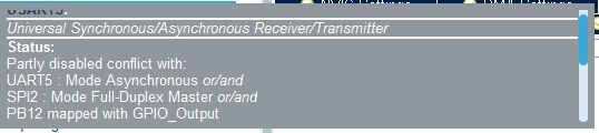

On STM32CubeMX, it said, UART3 has a conflict, does it matter ?
while (1) putchar(0x55);​
Use a scope so you can measure bit timing.​

Sorry I don't use CubeMX, what does the Reference Manual suggest are the connectivity modes here, and what pin conflicts are there. As presented you're showing with work with clock source X and failing with clock source Y
So I'd focus on the clock trees and sources, and determine is the clock routing is broken, for example you've selected a source that isn't present, or is at a different frequency.
Outputting a stream of 'U' characters (0x55) gives you something to measure on a scope. ie does something come out of the pin? is it the right frequency?
Try doubling or halving the baud rate you program whilst leaving the terminal at 115200. See data then?
