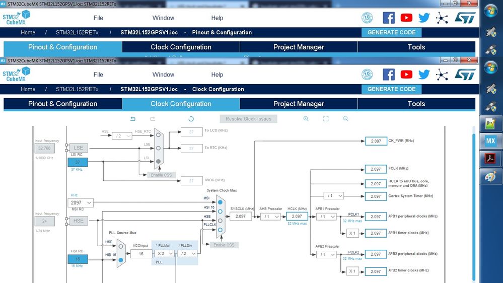

I changed my clock from MSI to HSI but my SPI and UART baudrate becoming wrong,
What do I miss here ?

If you change clocks on ​the fly, you'll have to change dividers dependent on them also.
antonius
Senior
0690X000008A1dtQAC.jpgyes what value for divider ?

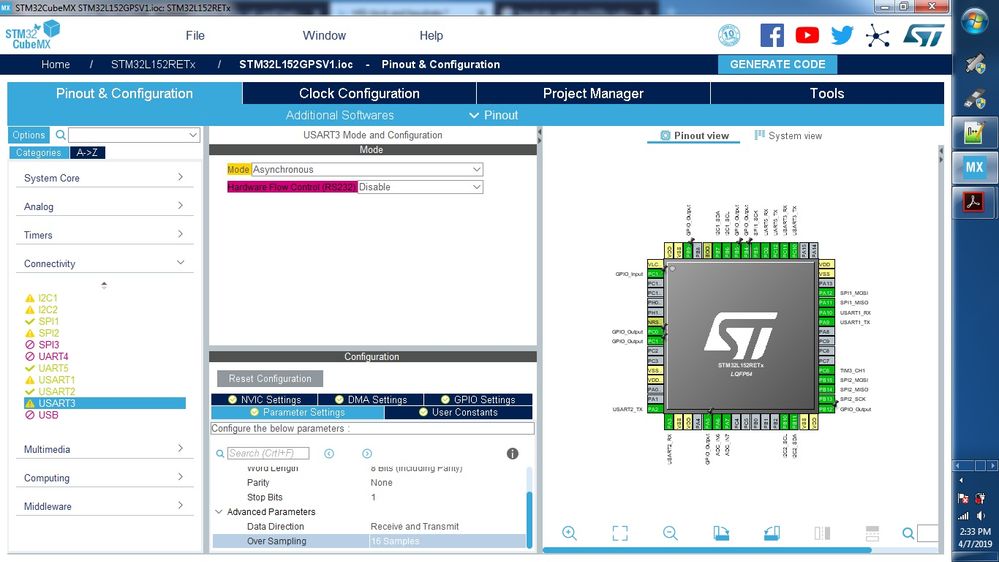

the setting for UART3
void MX_USART3_UART_Init(void)
 huart3.Instance = USART3;
 huart3.Init.BaudRate = 115200;
 huart3.Init.WordLength = UART_WORDLENGTH_8B;
 huart3.Init.StopBits = UART_STOPBITS_1;
 huart3.Init.Parity = UART_PARITY_NONE;
 huart3.Init.Mode = UART_MODE_TX_RX;
 huart3.Init.HwFlowCtl = UART_HWCONTROL_NONE;
 huart3.Init.OverSampling = UART_OVERSAMPLING_16;
 if (HAL_UART_Init(&huart3) != HAL_OK)
   Error_Handler();

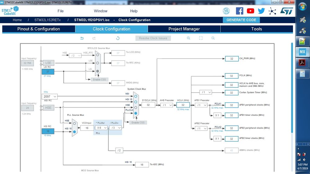

I put on 32MHz, only USART3 can not work properly
I make :
   USART3->BRR = 32000000/115200;
 // Configure BRR by deviding the bus clock with the baud rate
   Error_Handler();
