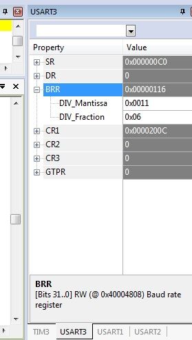

On 32MHz, on UART1, I still get the same issue ??
antonius
Senior
which one is related with UART3 ? APB1 or APB2 ?

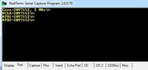

Core=2097152, 2 MHz
HCLK=2097152
APB1=2097152
APB2=2097152
I can't use VCP, I have installed it as a driver, but can not see it my device driver,
I'm using Win 7 64.
I tried with external 16MHz, but it's not responding, it returned to 2.097MHz always...
I have no clues why until this level, any other ways ?
