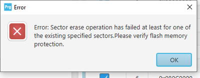

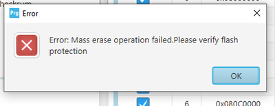

i am using same mcu i have this error in the begining like target dectection now that target is dectecing problem is resolved but  now getting this issue
STMicroelectronics ST-LINK GDB server. Version 7.11.0
Copyright (c) 2025, STMicroelectronics. All rights reserved.
Starting server with the following options:
Persistent Mode : Disabled
Logging Level : 1
Listen Port Number : 61234
Status Refresh Delay : 15s
Verbose Mode : Disabled
SWD Debug : Enabled
InitWhile : Enabled
Waiting for debugger connection...
Debugger connected
Debugger connected
STM32CubeProgrammer v2.20.0
Log output file: C:\Users\kavya\AppData\Local\Temp\STM32CubeProgrammer_a01920.log
ST-Link Server is running on port : 7184
ST-LINK SN : 34FF6B064154343122480157
ST-LINK FW : V2J46S7
Board : --
Voltage : 2.63V
SWD freq : 4000 KHz
Connect mode: Under Reset
Reset mode : Hardware reset
Device ID : 0x450
Revision ID : Rev V
Device name : STM32H7xx
Flash size : 2 MBytes
Device type : MCU
Device CPU : Cortex-M7/M4
BL Version : 0x92
Opening and parsing file: ST-LINK_GDB_server_a01920.srec
Memory Programming ...
File : ST-LINK_GDB_server_a01920.srec
Address : 0x08100000
Erasing internal memory sector 8
Error: failed to erase memory
Encountered Error when opening C:\ST\STM32CubeIDE_1.17.0\STM32CubeIDE\plugins\com.st.stm32cube.ide.mcu.externaltools.cubeprogrammer.win32_2.2.200.202503041107\tools\bin\STM32_Programmer_CLI.exe
Error in STM32CubeProgrammer
Board : --
Voltage : 2.63V
SWD freq : 4000 KHz
Device ID : 0x450
Revision ID : Rev V
Device type : MCU
BL Version : 0x92
Address : 0x08000000
Erasing internal memory sector 0
Shutting down...
Exit.

2 REPLIES 2
kavyamm
  can able uncheck the DMES , could u please us to resolve this issue
Andrew Neil
@kavyamm wrote:
i am using same mcu
And is it on the same board?
Did you check the solution provided in the other thread?
