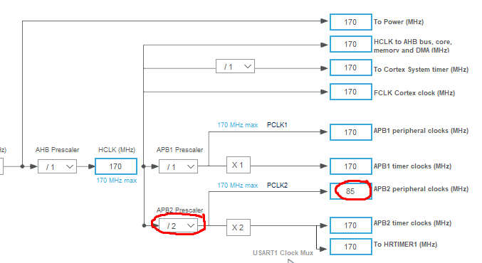

The problem is as follows: When I am trying to update HRTIM master timer registers (MPER, MCMP1-4) on the STM32G474 via Burst DMA access, every data word I write into the BDMADR register gets written into two of the specified master timer registers. So the first data word gets written into MPER and MCMP1, the second into MCMP2 and MCMP3, the third into MCMP4 and whatever has the address after MCMP4 (it's not a master timer register I think), and then it repeats. I have tried manually writing into the BDMADR register, used various DMA data chunk lengths, but to no avail.
I forgot to update it here because we already had a direct support ticket: The problem was caused by the APB2 being half of all the other clocks.

I'm not following why the APB2 prescaler being /2 would cause double writes?
I just checked the Reference Manual and the Datasheet and didn't see any requirements for clock frequency relationship between different clocks.
