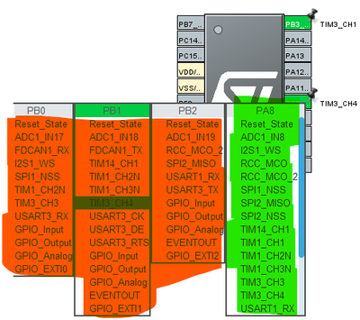

Example1:
PIN15 only the function on PA8 are working properly, neither (PB0,PB1 or PB2) are working at all with any function even a simple toggle. I'm pretty sure that the Alternate Function property are being generated correctly.

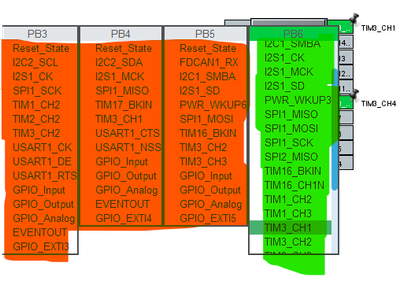

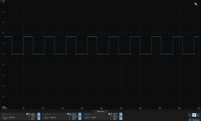

PIN20 Generating a PWM with TIM3_CH1 only works on PB6, if the same timer is passed to PB4 i can't get any output.
Same on PIN1 i can get output only on PB7.
There is the HAL_TIM_MspPostInit where PB6 is working as expected but PB1 isn't:

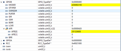

Register after init:

mƎALLEm
Did you configure SYSCFG_CFGR3/PIN MUX?

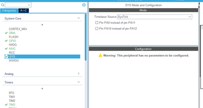

This is exactly my issue, thank you for helping me out. It's the first time that i use a STM32C0 or any mcu with shared pin, i didn't read enough deeply RM0490. MY BAD.
Why in hell they don't put nothing in the sys mode and config?
Even in the datasheet they only talk about PA11 and PA12.
"Pins PA9 and PA10 can be remapped in place of pins PA11 and PA12 (default mapping), using SYSCFG_CFGR1 register."
