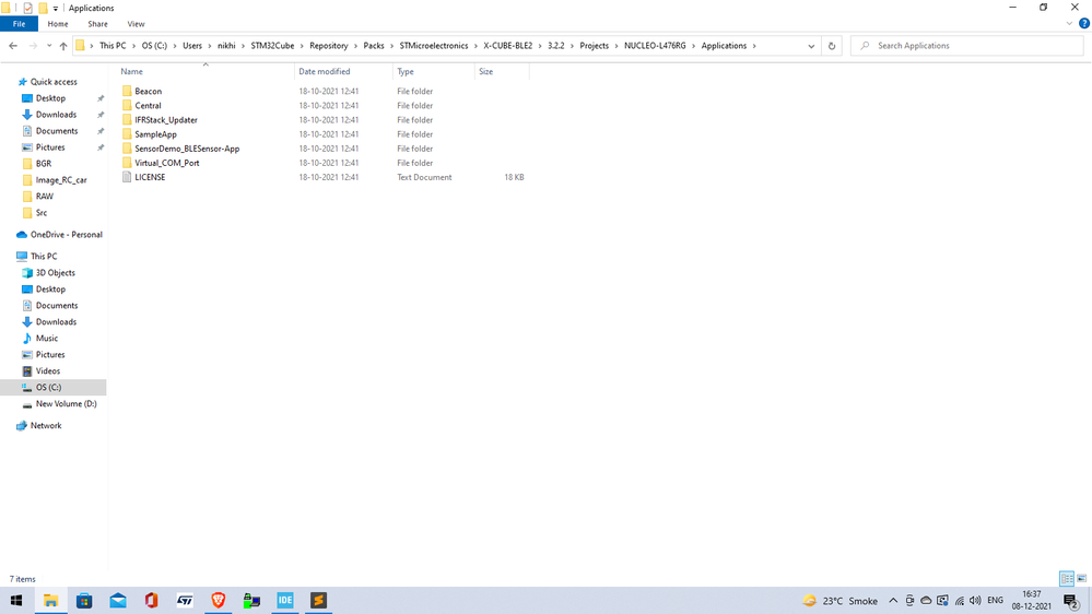

I am trying to a develop application that have Temperature sensor and i want to send data to app. but when the device is not connected then i want to put BNRG2A1 in low power mode. what is the way to do that i am using X-CUBE-BLE2 software package in that no example provided about low power mode.@Sebastien DENOUAL​ @s2​ @s23​ @s239955_stm1_st​ @AStev.4​ @salbuquerque9​ @a239955_st​ @s239955_stm1_stmicro​

0693W00000HnuuLQAR.png@Imen DAHMEN​ Ya that's right but i want to develop the battery operated devices for that i want use BNRG2A1 in low power mode. In the repository there is no example provide about low power mode.
