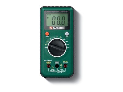

The board has a IDD jumper (JP6) for MCU current measurement so I attached a Parkside multimeter to get the current.
You mean something like this:
You won't get a meaningful measurement of dynamic current consumption with a multimeter (any multimeter) - you will need something like the X-NUCLEO-LPM01A or STLINK-V3PWR (and associated software) to get a meaningful view of the current with time

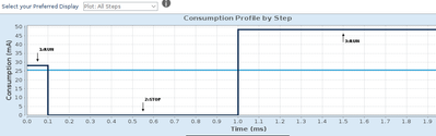

You can check this a bit in Cube , with the "tools" , to see some average, if using peripherals, or not :
What you "pull" extra current out of some pins you switch, you have to add yourself.

About the PCC (Power Consumption Calculator), it's not useful for me because I use a HCLK frequency of 4 MHz (from SYSCLK of 16 MHz with HSI source mux) and in the step parameters of the tool you must use a minimum frequency of 30 MHz. Moreover, all the run-mode current consumption measurements given in that tool are performed with a reduced code that gives a consumption equivalent to CoreMark code; that values are higher than the values shown on the multimeter.
