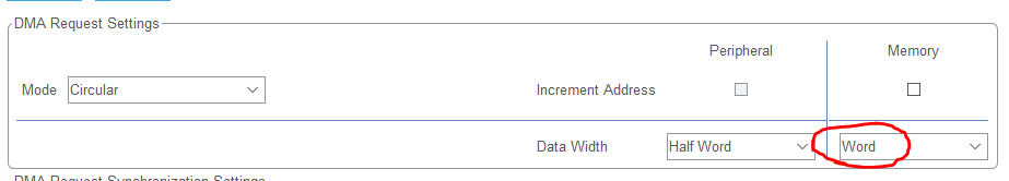

I'm trying to send data from ADC to FMAC directly via DMA in circular mode. From the STM32G4 reference manual (dm00355726) page 402:
"Peripheral-to-memory, memory-to-peripheral, memory-to-memory and peripheral-to-peripheral data transfers"
But I can't find anything on STM32CubeG4 that configures that. Here's a screenshot:
I've tried writing to FMAC write data register directly using
HAL_ADC_Start_DMA(&hadc1, &FMAC->WDATA, 1)
But it doesn't work.
What worked for me was setting the DMA circular mode for both ADC and FMAC, then syncronize it using DMAMUX requests. Although this eliminates the CPU in the process, it doesn't feel like a true peripheral-to-peripheral transaction.
How can I make a DMA transfer content from one peripheral to another, directly?

2020-12-08 1:15 PM
Ok, now I've got everything working now. The Half Word data width in ADC DMA configuration was the problem. Once I set up as Word, everything started to work.
Not sure why this gave me problems, the UART did work just fine with the ADC as Half Word (actually I thought it should be byte). The FMAC on the other hand, refuses everything except Word.

2021-01-06 4:17 AM
The APB peripherals registers are accessible through Word access (32-bit). If there is 16-bit or 8-bit access then this access is transferred into 32-bit access. As written in RM0440 (Chapter 2.1.5 Bus Matrix):
Note: When a 16- or 8-bit access is performed on an APB register, the access is transformed into a 32-bit access: the bridge duplicates the 16- or 8-bit data to feed the 32-bit vector.
This is probably reason why the USART worked also with half-word access (USART1 is on APB2 bus).
The AHB peripherals register access is defined for each peripheral in registers description (RCC, Flash interface registers, CRC, DMA, DMAMUX, CORDIC, DAC, RNG, GPIO). For the FMAC (which is also on AHB bus) is there no definition written in RM0440. I think that access is usually 32-bit only (if nothing else is written in RM0440).

2021-03-02 9:16 AM
You are right - those register can be accesses only by 32-bit. This is mistake in RM0440 (for WDATA and RDATA registers). All FMAC registers should have only word access. We will modify description of WDATA and RDATA FMAC register: "Access: word access".
I have tested the behavior (DMA and direct CPU write to WDATA register) and tests confirmed that 16-bit access is not working (only 32-bit access is correct).
