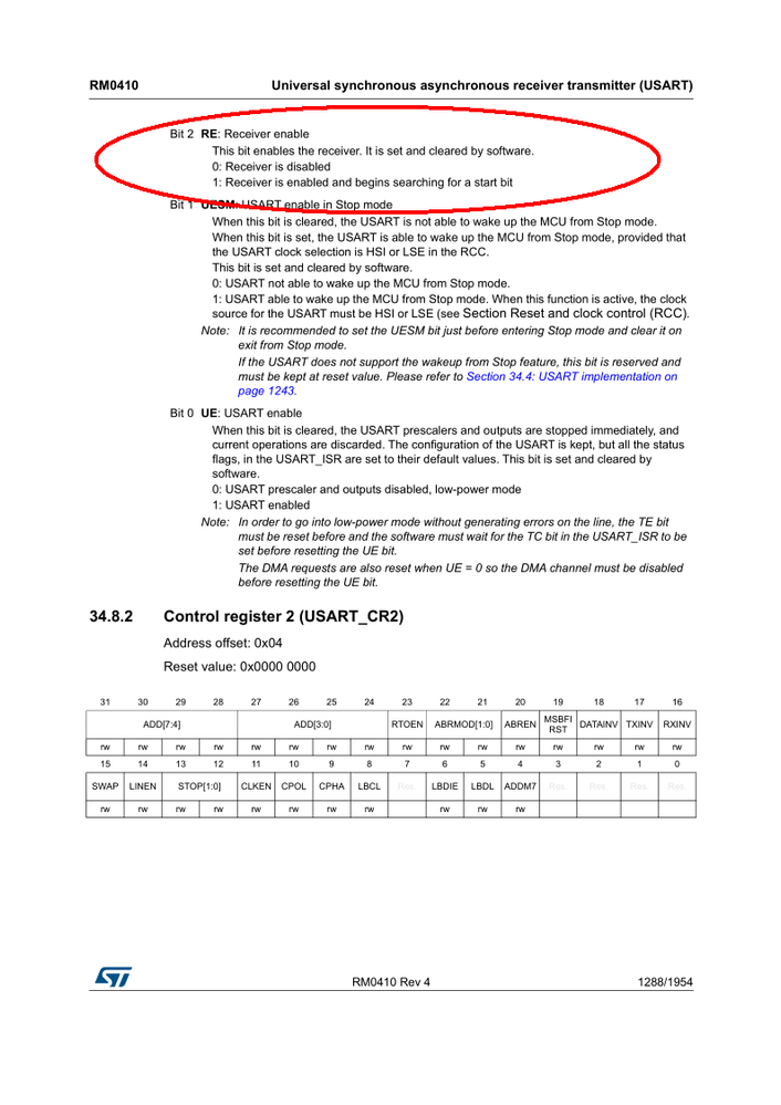

waclawek.jan
July 22, 2021
0693W00000D0KcCQAV.pngJW

thanks for the tip. I'll check and implement it...
Regards.

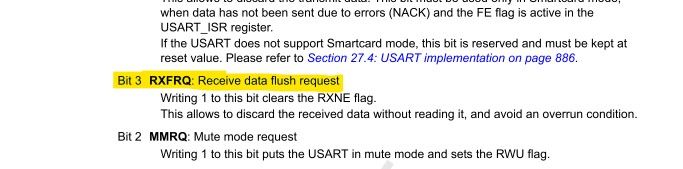

Guenael Cadier
August 2, 2021
0693W00000D1HJ9QAN.jpgIn case you want to restart reception with a clean (empty) Rx content (and discard a data that might have been received prior you disable/enable RE), you could also flush the RX path by writing 1 in RXFRQ bit in USART_RQR register.
