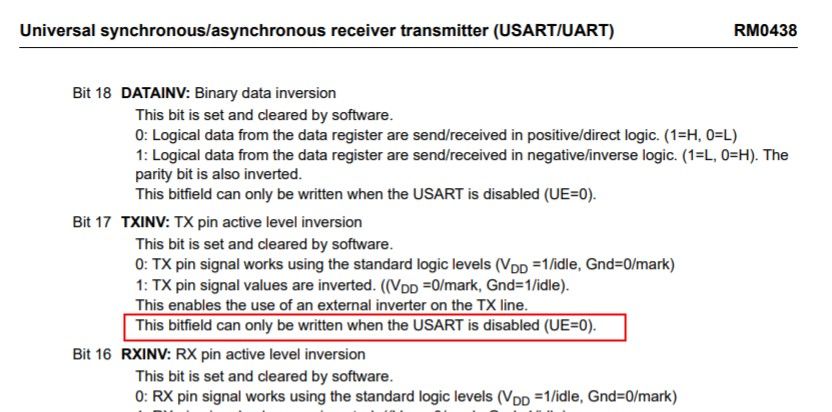

Excuse me, how to gracefully and effectively change the TX pin "inversion" of usart3 during the operation of MCU program?

__HAL_UART_DISABLE(&huart3);
USART3->CR2 |= (1 << 17);
__HAL_UART_ENABLE(&huart3);
‎2021-08-02 6:17 AM
Yes, you need to clear the UE bit in CR1 to change change critical settings, like this or baud rate (BRR). But be careful when you do this, make sure you're not in the middle of sending a byte, etc.
