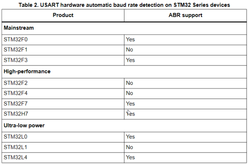

Was it possible to perform ABR with F4?
Since I think on table 2 it is marked as not being possible :
‎2022-06-10 2:51 AM
Seen at the AN4908
‎2022-06-10 4:03 AM
The 'F4 UART does not implement the automatic baudrate detection in hardware.
You still can do it in the old fashioned way, by measuring duration of incoming pulses and calculating baudrate from it in software. See link in the original post.
‎2022-06-10 5:15 AM
Ah okok I i think I get it.
It would be the chapter 4.3 ...
Thank you!
