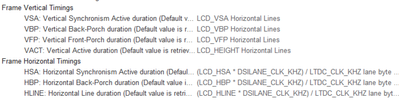

Good afternoon,

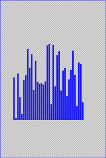

For a couple of months, we have been having the same issues while integrating a slightly different controller (Sitronix ST7796).
All the points that jadczak_slr is mentioning are somehow the same as we are facing.
We managed to get something partially displayed (1/3 of the display has the image warped by 45 degrees) using the CubeMX configuration but it's really flaky: as soon as the content in the framebuffer is changed - e.g. adding different colors, drawing on different areas - the result spans from being worse to completely broken (blank display).
The picture shows the best result we could achieve, and how it should look (the bars' height dynamically changes over time so they don't match 1:1)
Are there any updates that could help us proceed with the development? At the moment we already tried all the possible combinations in CubeMX.
Looking forward to receiving your kind support,

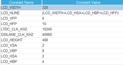

Explorer

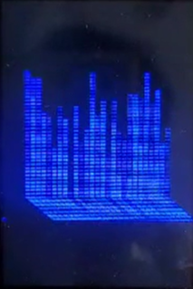

February 19, 2024
I just wanted to update the thread because we managed to have something displayed. It still has some bugs (but that could be related to other issues not strictly related to the U5 or the controller).
We started with an example from the TouchGFX which was also based on RGB565. We made some changes according to the controller pseudocode given by the display supplier and some hit&tries.

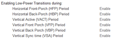

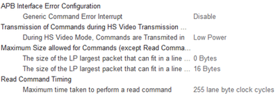

The crucial parts were the following:
  • Enable all the low-power transitions in the DSI section
  • Set the main parameters as the following, used for both the LTDC and DSI sections

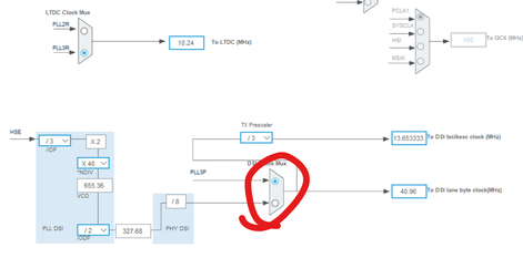

  • DSIHOST configuration:
  • Clock configuration. Note the source of txclxesc and DSI lane byte clock source is not the DSI PHY but the PLL3P. Also the LTDC clock has PLL3 as the source. The PLL3 is derived by the HSE like the DSI PHY. In this way, we have "in-phase" clocks multiple of each other for the whole "subsystem".
Tell me if this helped you somehow.

Visitor II
November 5, 2024
Did anyone figure out why PLL3P needs to be used and PLL DSI is not ok?

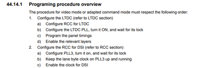

April 24, 2025
There are no issue with the PLL DSI within the RM0456, section 44.14.1 "Programming Procedure Overview," the MIPI clock source should initially be set to PLL3 then switched to D-PHY PLL
Regards,
