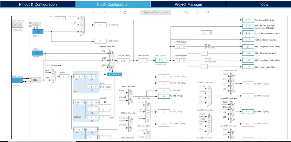

I have created a simple project, where I need to get the interrupt at exactly 1us.
Please find attached an image of the clock configurations that were created in STM32Cub3MX.
I am using TIM3 which is associated with APB1, so the MAX frequency for this would be 108.
Please find below the configuration of the TIM3.

uint32_t PULSE_WIDTH = HAL_RCC_GetPCLK1Freq() * 2 / 1000000 ;

With the above setting of Prescalar & Period, The least interrupt trigger interval I get is 1.6us, But I need exactly 1 us.

Find a way to solve your problem without interrupting at 1 MHz
The Period value here should be higher to get 1 MHz
2020-12-30 1:14 AM
There is a big difference between toggling a GPIO and exceuting an interrupt handler @ 1 MHz. If you set TIM10 to PWM channel 1 output, you can toggle PB8 @ 1 MHz without any interrupt handler. An interrupt handler needs few dozends of MCU cycles for saving and restoring the MCU state. @ 216 MHz MCU clock there are only 216 machine cycles between interrupts, not much room left for doing useful things.
