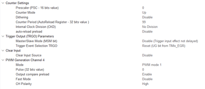

This is my timer configuration (TIM5 global interrupt enabled):

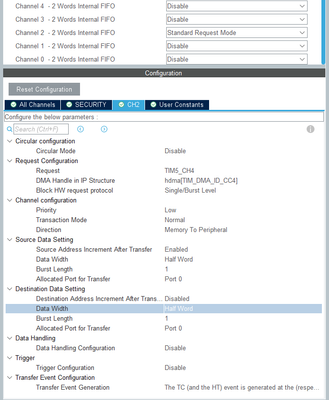

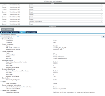

This is GPDMA configuration:
Using a scope, I see that a PWM signal is generated but the HAL_TIM_PWM_PulseFinishedCallback() function is never called, which in the end, stops the DMA transfer.
Would really appreciate any help.

In your GPDMA configuration, in the destination data setting, try enabling the destination address increment after transfer

Thanks @Sarra.S for your quick response. I tried your suggestion without success.
Timer configuration is the same because basic PWM generations works.

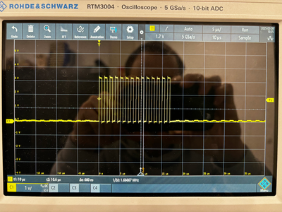

Unfortunately is set 24 different duty cycles in my code and get following result using a oscilloscope:
Any idea why only 14 cycles are outputted?

We had a similiar error with GPDMA. What helped us, was changing Data width to "Byte" in Source data setting and destination data setting in GPDMA configuration. Also then you have to change
uint16_t pwmData[24];
to
uint8_t pwmData[24]
